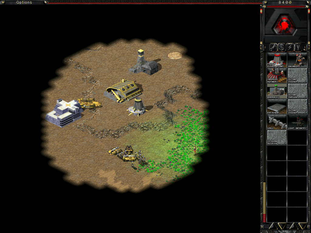

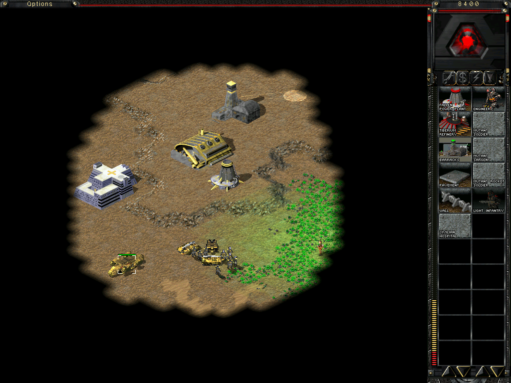

I stumbled across this accidently. This is very simple. Just build a building like the dropship pad and give it the Drop ship as a free unit. The unit will work fine. But if you build it on a air pad like normal it will do that semi-retarded pilot-at-the-controls thing. Here's screenies of it working properly.
 Filesize:  484.85 KB
 Viewed:  16932 Time(s)
 Filesize:  483.41 KB
 Filesize:  481.82 KB

I've tested this and let's say it worked and it didn't work...
I've simply added FreeUnit=DSHP to the barracks.
It didn't worked exactly as I expected. When the game started, two dropships started with my MCV. These dropships carried passengers perfectly and had no problem when loaded. When I built the barracks, no new dropship appeared O.o.
So, this is a nice solution, but it needs some development Smile. Or maybe I did something wrong... should I change the techlevel from the dropships #Tongue... maybe techlevel=-1 can cause this problem O.o... although when you play with TechLevel=1, the refinery free a Harvester, but the Harvester is tech 1. I'll do a new test with Dropship at Tech 1.

Sorrow wrote:
I think that any unit that is a freeunit automaticaly becomes a vehicletype...
Unfornatelly, you are right.
I managed to reproduce his trick and I've loaded my orca transport with 3 soldiers. Then, I took it in a Nod base after scouting it. The Nod base has some cyborg reapers and rocket soldiers, so it was a perfect testing place. It was invincible on air Sad.
PostPosted: Fri Jun 17, 2005 1:21 am
